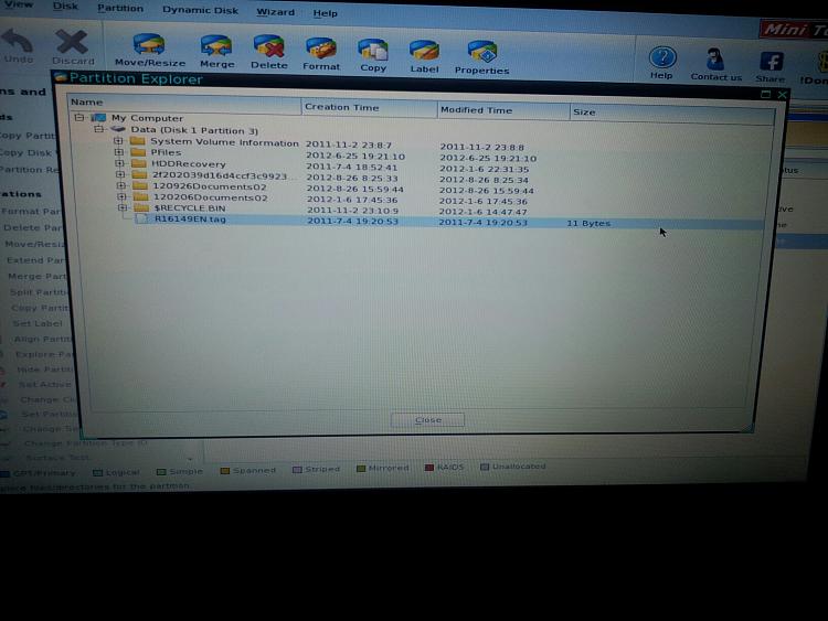

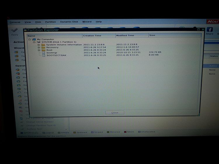

    Next I went to the MIni tools partion tool. rebuilt MBR,,,,tried to reboot...as before, default to widows start up repair recommended,,,blue screen...etc.....
    Here are the photos of the partitions;

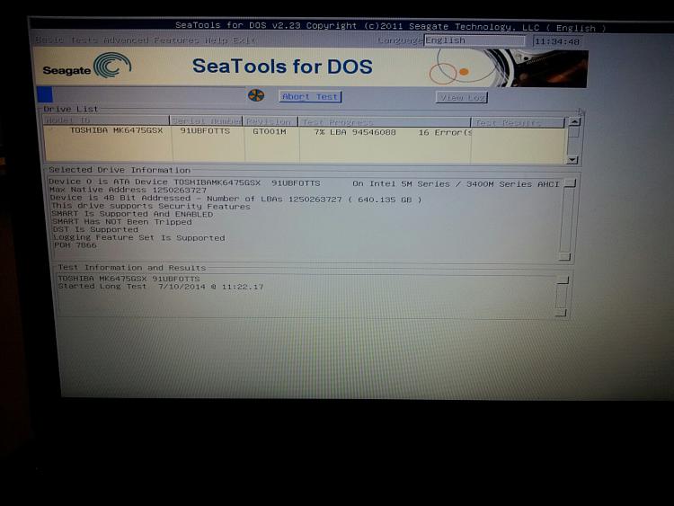

    Next on to Sea Tools download.
    I am currently running SeaTools for DOS which is taking forever the picture shows 16 errors detected at 7% of scan.
    Currently at 33% and still 16 errors detected.........I assume I should continue?

    You are doing great, learning and progressing.
    The HD tests do not look good but Seatools results should determine whether you keep the HD or replace it - ideally with an SSD for unbelievably fast performance. Google a video for your "PC model + replace hard drive with SSD" to see how to access and replace.

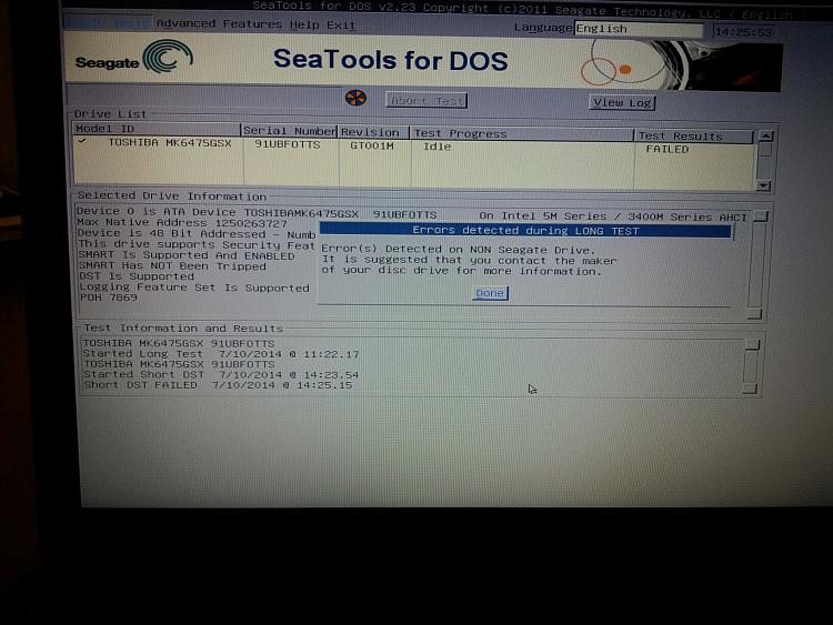

    I was waiting for the results of the SeaTools Hard drive test, which took around 3 1/2 hours.
    The outcome was that it failed both the short and extended tests.
    Photos attached with the logs.

    So, based on logs and test results, is it safe to say I cannot proceed from here until I change the hard drive for another...at which point hopefully an ISO will boot up and I can use my existing code.

    Yes, everything you need has been outlined already. Ask back any questions.
    Keep the thread open until you have your new SSD (preferred) with a perfect Clean Reinstall - Factory OEM Windows 7.

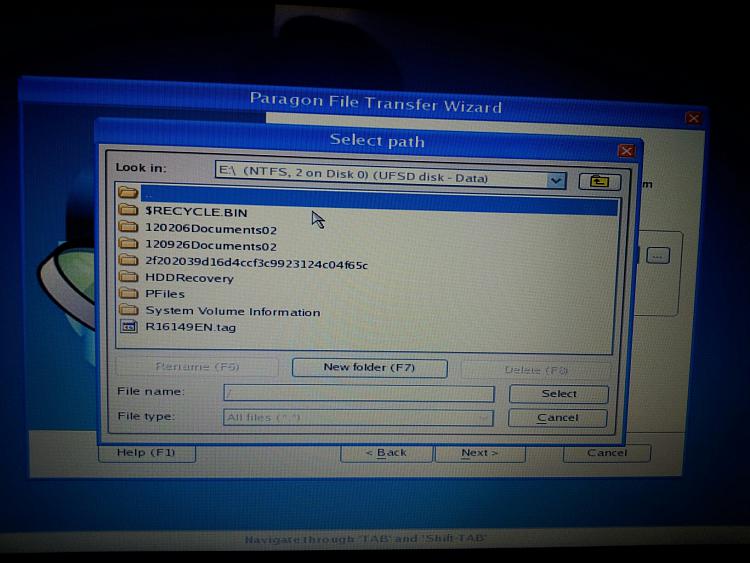

    I am running Paragon from the CD/DVD drive and have a fresh formatted USB flash drive in the USB port.
    I need to find a path to send the files on clipboard, but it doesn't seem to recognise the USB drive as an option?
    Please advise where I should send the files on the clipboard to retrive them.
    Screen 1 shows clipboard
    Screen 2 shows Path destination.
    Cheers..
