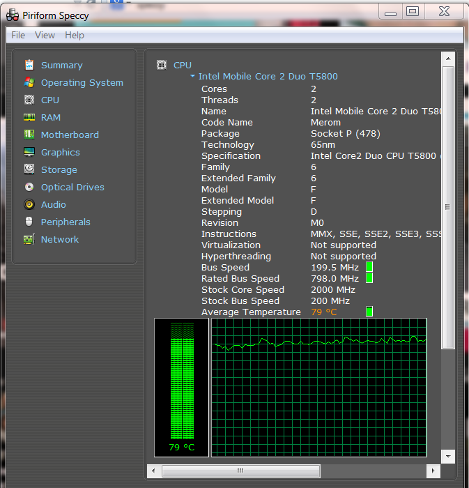

I'm visiting a friend who has an old Toshiba laptop he uses in his room on his bed. I'm surprised it has lasted this long as it gets thrown around a lot and I think the air vent gets blocked too much on the bed.
He said it's been shutting down so I checked it out and it seems that Core Temp was sending it into Hibernation after I enabled Overheat Protection in November on it, trusting the CoreTemp designated TJMax at 185F, which for some reason it triggers an overheat around 177F and goes to Hibernation. He says it does this too much to use it.
So I researched the CPU (Speccy attached) and found it's max is 100C, reset Core Temp to that for Overheat shutdown and it has been running OK but at about 60-80C with a hot keyboard in the torture tests I've done for 2 two hour sessions today.
I blew out the tiny air port underneath which vents a working fan to the side. I don't really want to disassemble it to repaste CPU unless it's too seriously overheating to ignore. But I don't trust Core Temp now, and don't see anything in BIOS about any overheat protections there. Is it known that Intel Core Duo shuts itself down if it overheats before it burns up?

Hi Greg,
79C is getting up there, depending on what work is being done. The first step is to blow out the fins, which you have done. But I have gotten in trouble doing that when cats are involved. Their short hair often balls up and impedes or outright stops the fan, which is disaster.
If that's not a problem, the next question is whether the fan is blowing air at a temperature commensurate with that of the CPU/GPU. This is an intuitive thing. If the exhaust is about the right temp, that means that the thermal paste is doing its job. If it's not hot enough, a repaste is called for. If there's any doubt, a repaste with quality paste should be good for a few degrees relief at the least.
If you do break it down to repaste, oiling the fan can reap great results.

If its 70c at load on a T5800 that seems fine to me since its idling at 54c you might want to repaste. Just take your time with the dis-assembly and use a guide like Icit2lol suggested. Take pictures when you start to take apart the inside and label your screws.

Greg, I would repaste it if it is getting within 20° of shutdown temps. To me, that's entirely too hot. At the same time I can understand your reluctance to do it. But, to me, within 20° of shutdown is entirely too hot.

The highest it's gotten is when I tried to install SIW and it nearly locked up everything while I watched temps climb to 85c.

Above link at Intel says TJmax on a T5800 is 85 C. Not 100. Or am I misunderstanding?
85 C is 185 F.
My System SpecsSystem Spec
09 Apr 2015   #10
gregrocker
Microsoft MVP
Yikes! Thanks for the correction. I only plucked the temp I saw first in the Google Search results for the CPU.
