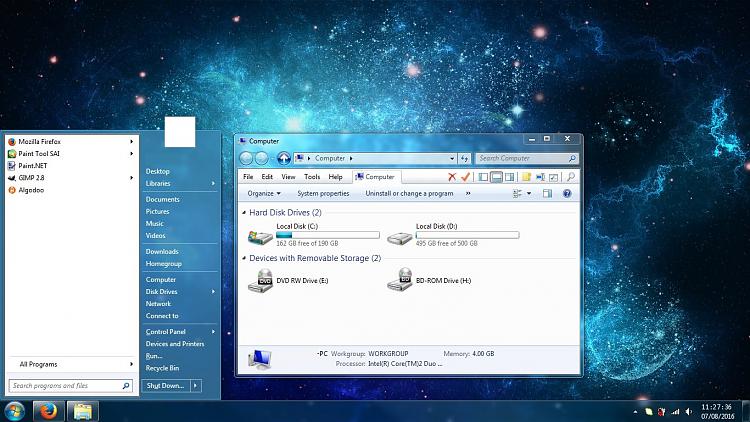

    Strange, very strange situation I'm having right here. Whenever I open any explorer window, the icon on the taskbar appears as "Run" command instead of the usual Windows Explorer icon. It's rather annoying to say the least, quite confusing too. Any idea why this is happening and how I can fix it? It acts as if it was a "Run" window, too (when you press Windows+R) but it has a different icon. Please see attached screenshots, it's really strange.

    Hi Ranger4, and thank you for your reply.
    I am not using the default Windows start menu, but ClassicShell. The "Run" is not in the default start menu, and I don't believe it has anything to do with this. This is a fresh install, it was never checked either way.
    To clarify, in case if my first post is not clear enough. My issue is the following:
    - When I open any Windows Explorer (file browser) window, through anywhere (Win+E, Start>Computer, etc) its icon on the taskbar isn't the usual "Windows Explorer" Libraries icon, but something that looks somewhat like a "Run" prompt icon. When I Shift+Click it (which would normally open another instance of Windows Explorer) a "Run" prompt comes up, with a similar icon.
    This is not normal behaviour, and I am trying to figure out what is causing it, and how to fix it.

    I have figured out what the problem is. Thank you both for hinting at ClassicShell and running SFC.
    "classic shell" "start menu" "taskbar" "system files"
    Those words made me wonder whether it could be related to something I did recently, which was to delete all contents of "Start>All Programs" and create custom folders with categories for programs.
    I've put the default folders back to their directory - "C:\Users\USERNAME\AppData\Roaming\Microsoft\Windows\Start Menu\Programs" and surely, after restarting Explorer, the icon is back and works as it should.
    Turns out that Windows Explorer NEEDS the "Accessories/Windows Explorer.lnk" shortcut in start menu. If it is removed, it'll cause this strange behaviour.
    Another solution to this, if you really want to get rid of the "Accessories" folder is to pin Windows Explorer to taskbar.
    Thank you all for help!
