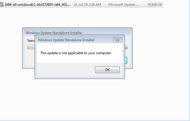

    1. After attempted the first suggestion, that did not work and was advised to install another update prior to the link posted. So I reset the updates as outlined in the Tutorial - Windows Update - How to Reset - Option Three
    2. Went to control panel - Windows Update - Search for updates - this went for seven hours to no avail.
    3. Clean boot - Installed IA64-all-windows6.1-kb3172605. It came up with an error message.
    Do I start a new thread? I really wish to have updates operating back to normal.

    Attached Thumbnails Attached Thumbnails Windows 7 Clean Install constant shut down-update-check-13-08-2016.jpg   Windows 7 Clean Install constant shut down-update-message-15-08-2016.jpg

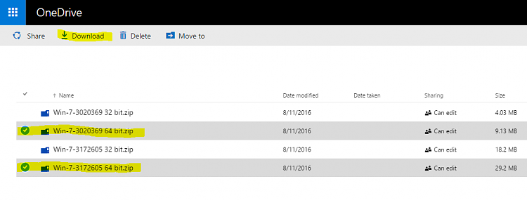

    You are having this issue as you are installing the update for Itanium systems as well as server edtion and not WIN 7 x64 systems.
    Use ThrashZones link instead and only download the x64 ones.
    https://onedrive.live.com/?authkey=%...A2DC8F8EEEC3C8
    You should have picked the one in yellow in your old picture, also don't worry it's an easy mistake.
    Attached Thumbnails Attached Thumbnails Windows 7 Clean Install constant shut down-catalog-kb3172605.jpg   Windows 7 Clean Install constant shut down-updates.png

    The only 2 reasons you'd get that message is if KB3020369 is not installed it does need to be installed first,
    Or if sp1 is not installed.
