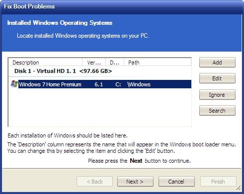

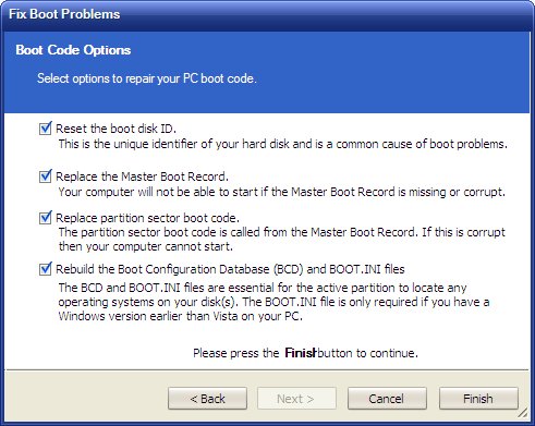

So these should be the steps to try:
  1. Remove any other HDDs so you don't confuse Macrium Reflect.
  2. Boot from Macrium's Rescue media (bootable CD or flash drive).
  3. Select the [Disk Image] tab, and note the drive letter assignments in the right pane. Hopefully, Macrium will designate C: as your OS partition.
  4. Select the [Restore] tab, then click "Fix Windows Boot Problems" in the left pane.
  5. In the pop-up "Fix Boot Problems" window, Macrium should find the Windows installation on your OS partition. Select it, and click [Next].
  6. At the "Active Partition" screen, you'll probably have all four HP partitions shown. Select the SYSTEM partition, and click [Next].
  7. Leave all four Boot Code Options selected, and click [Finish].
  8. When Macrium is done, remove the Macrium boot media and see if the system will now boot.
FTR, I tested the above in a virtual machine to make sure it works and to get the screen shots below. In my experiment the OS partition had been active and there was no SYSTEM partition. Before letting Macrium at it, I used a partitioning utility to created a new blank partition with no boot information in it in front of the OS partition. Macrium had no problem subsequently turning it into a bootable System partition.
