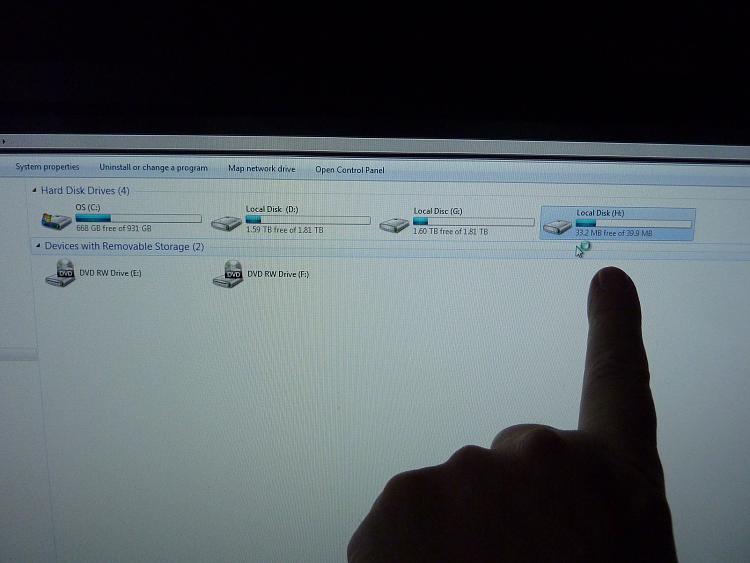

    ( see local disc H in pix if you open it says efi???) Now how do I get rid of that?
    I did not have a USb stick handy so I burned the ISo to a CD and booted from that and got your desktop? Again what was I supposed to do with that? Try running the cmd prompt there?
    Ok so now Im really lost, tried running from cmd admin and no luck and then I also see a new drive in my computer
    Again Im not really a techie and am really afraid or screwing something up again.
    Do I need that extra H in my computer if not how do I get rid of that?

    Ok so I tried running that cmd from your desktop and no luck, again I do not know what Im doing and would really like to know how to get rido of the H drive that is not in my computer?
    - - - Updated - - -
    I see that the H also shows up here in computer management, now how can I safely remove that? I just finally go the PC to at least be able to use the different startup options in msconfig and I can live with the way it is..
    I created a cloned HD of the OS and have Acronis so I guess that the need for a startup repair option in windows or burning a Windows repair disc at this point is just not worth the trouble especially even with your help is above my knowledge base.
    hopefully you can walk me on how to get rid of the H drive

    Now we see the oobedone.flg, that indicates that H is the DEll utility partition which is used by the DEll diagnostics.
    Can I remove this partition to get rid of the H drive my mu computer?

    SIW2 said:
    Why?
    They H drive has never even been in my PC and serves no purpose that I know of and since I know little of what I'm doing it really bothers me and as far as Dell the PC no longer has any support.
    If I can I would like to remove it and just live with the PC in the state that it is, I have been on this for days and have had enough ;-)
    Or is ther e a way just to get rid of the H drive my my computer? and leave the partition ?
    Could I just remove the drive letter in computer management? that would get rid of the H drive my my computer?
  10. Posts : 15,714
    7 X64
       #20
    If youget rid of the partition, I dont know what effect it would have on the Dell diagnostics.
    Running Dell F12 Preboot Diagnostics - YouTube
    Why not just remove the drive letter so that you dont see it in explorer.
