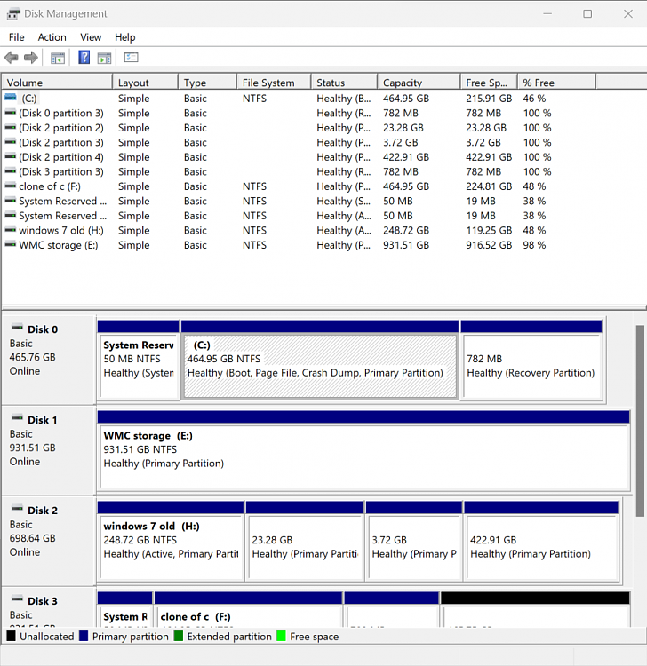

    I have 4 drives, main one win 11 pro
    Another drive has win7 ultimate, mint and ubuntu
    the other 2 drives are data drives, one for WMC running off win 11 pro, the other a cloned copy on win 11
    grub is only installed on disk 2, like to keep it like that
