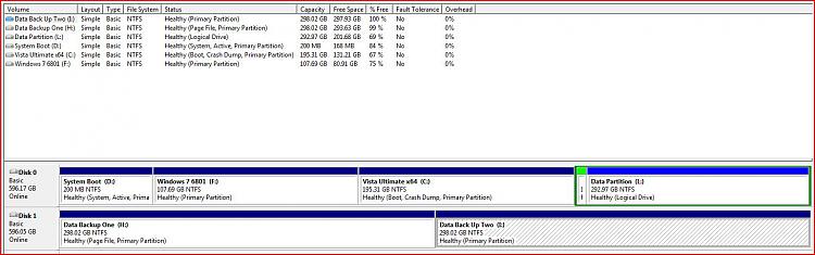

    Hello SIW2.
    So this helps clear up what I've just done; as this is my disk management shot.
    Just to confirm: Windows 7 is now ready to be removed with no problem; correct?
    For those that don't know; this is the thread I started about this earlier.
    Thanks!
    Later Ted

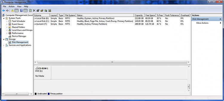

  7. Posts : 4,282
       #37
    Can someone explain what's happening with mine.
    B:\ Vista
    c:\ Windows 7
    f:\ external hard disk
    This is the view from within Windows 7
  8. Posts : 15,923
    7 X64
       #38
    Hi Mr Grim,
    B ( in this view ) contains Vista boot files and Win7 boot files , it also contains Vista o/s.
    C ( in this view ) contains Win7 o/s files.
    Your external hd is marked as active as there is only one partition.
    If you carve it into several partitions with Disk management , i.e shrinking from the right - you will find the partition on the left ( with lower address numbers on the hd ) will remain the Active partition by default.
    Hope that helps
    SIW2

  9. Posts : 15,923
    7 X64
       #39
    Hi Smarteyeball,
    Thanks for posting the screenshot - it's interesting.
    I installed 7 first on a new HD and then Vista after 7. Your setup may be different:
    7 created a small (200mb) partition at the beginning of the drive (containing all the boot data) and then installed itself on the next partition.
    So my system looks like:
    Hd0,0 (200mb boot data)
    Hd0,1 (107GB Windows 7 6801)
    Hd0,2 (195GB Vista x64)
    Hd0,3 (290GB Data)
    Both 7 and Vistas boot data reside on the 200MB partition. In my case, deleting that 200MB partition will wipe out Vista's boot as well.
    Was that a new hd that you partitioned with Win7 during the installation ?
    Everyone else seems to have installed after Vista and got the expected result , i.e. 7 installs it's boot files on the existing Active partition ( which for most people is the partition that already contains Vista's boot and o/s files ).
    As you installed 7 first , it seems to have made it's own additional first partition.
    Anybody else done the same thing, and got the same result?
    It's a good thing as you can make an image of that 200mb partition to restore in an emergency. I have the Paragon Drive Backup, which lets you make a small bootable cd - so you can boot in , find the backup image and restore it - I assume Acronis etc are pretty much the same?
    You could try using EasyBCD to remove the 7 boot files from the 200mb partition.
    You might find that Vista doesn't know they've been removed and will still show 7 as a boot option. In that case it can be deleted from the boot tab in msconfig.
    It will be fun to see how this pans out for us all
    SIW2
