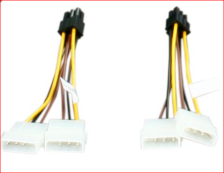

Looking at the specs that Punkster found for that Echo Star, it looks more like a 400 W (if you're lucky) with a 650 W label on it. There is just no way that that thing will be up to running a GTX 470 as well as the rest of the system. It also doesn't have any PCI-E 6/8 pin connectors on it, of which the GTX 470 requires 2 of the 6 pin. Some of those cards come with molex to PCI-E adapters like this,
which from the specs listed for that power supply with only 4 molex connectors to begin with, not only would the video card need all four of them, there wouldn't be any left for anything else.
