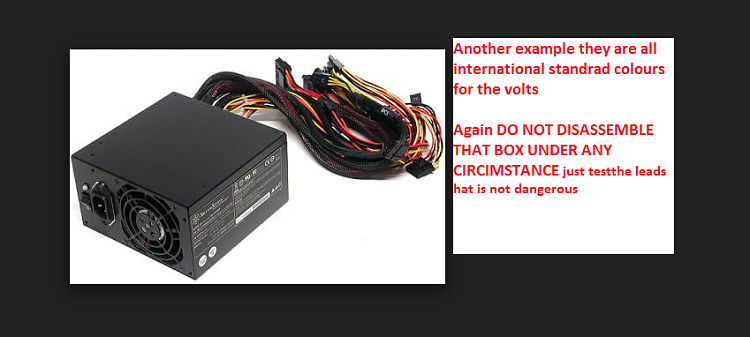

Now you need a digital multimeter they are really cheap and you just need to unplug the 24 pin plug and insert a paper clip into the green socket and one of the black ones (see below ref) - there is one next to the green.
This will start the PSU up and then you just test every socket on that plug using the black meter lead to a black cabled one and the the red lead to the orange red and yellow leads look at this and the other link to see the volts for the colours yellow is 12v red is 5v and orange is 3.3v. Don't worry too much about the blue or grey at this point. You also test any other leads like thr CPU ATX plug and any GPU leads
https://www.sevenforums.com/tutorials/86648-psu-jump-start.html
for volts refrence
http://www.tomshardware.com/reviews/power-supply-specifications-atx-reference,3061-2.html
this will show the colours better in the pics but please and I do not want to frighten you from trying but DO NOT ATTEMPT TO TAKE APART THAT PSU CASE
No sign of output from computer-psuco2.png   No sign of output from computer-psuco4.png
My System SpecsSystem Spec
