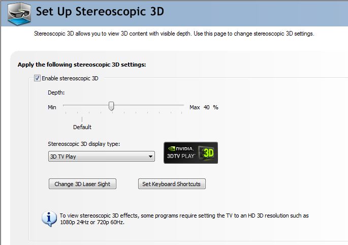

    Looks good to me, I'm glad you didn't go for the 620, it's a budget card that's comparable to intel onboard GPU's, 650 would be more than enough to run 3 displays for everyday use, I use mini HDMI to HDMI which is pretty much the same as Mini HDMI to DVI-D, it works brilliantly, so much so that i use it for 3DTV play, See screenshots below.
