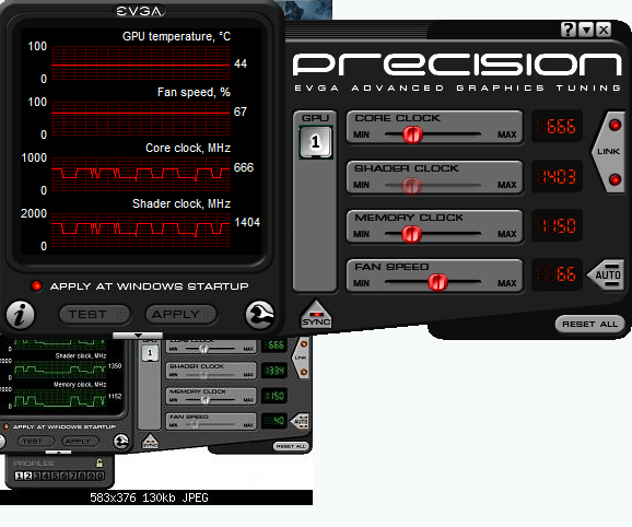

  7. Posts : 4,282
       #337
    Strange I am also using the new 190.40 drivers and the clocks are still jumping although not as bad as they were with 190.38.

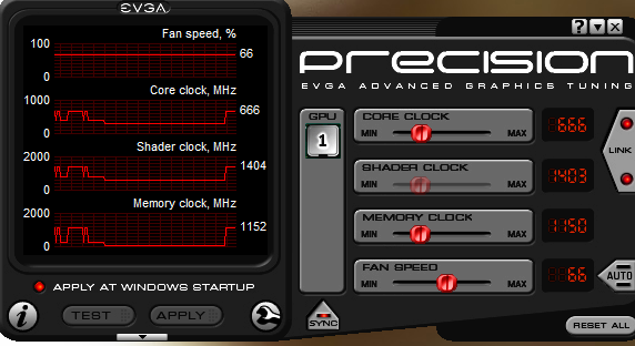

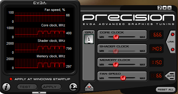

  8. Posts : 4,663
    Windows 7 Home Premium 64 bit
       #338
    Hi Folks.
    I installed the 190.38 drivers and noticed the clocks jumping around. I then went on to try the 190.40.
    I notice that if I do absolutely nothing the 190.40s show a steady line at about half my set clock speeds.
    If I do something, in this case running my mouse pointer along rocket dock so the icons zoom in and out, the up and down jaggies start.
    Here are some pics to illustrate the point. First pic 190.38 with nothing happening, second two pics 190.40 with me running along the rd icons.
    I haven't tried either in games yet.
    What's going on? Are these drivers bad?
    Cheers, John:)
    ps also note that my gpu temp is now missing in the display with 190.40 and I don't know how to get it back
    Attached Thumbnails Attached Thumbnails Latest NVIDIA ForceWare Video Drivers Windows 7-evga90.38.png   Latest NVIDIA ForceWare Video Drivers Windows 7-evga90.40.png   Latest NVIDIA ForceWare Video Drivers Windows 7-evga90.40-2-.png
  9. Posts : 7,878
       #339
    Aren't the clocks just slowing down to consume less power and resources when it's really not needed? I'd assume this is a power saving feature...like Intel SpeedStep.
  10. Posts : 4,282
       #340
    johnwillyums said:
    Hi Folks.
    Cheers, John:)
    Gaming seems to be great on these drivers and I haven't had performance issues anywhere with them, the only issue is as you have noticed with the clocks not remaining stable when idle.
