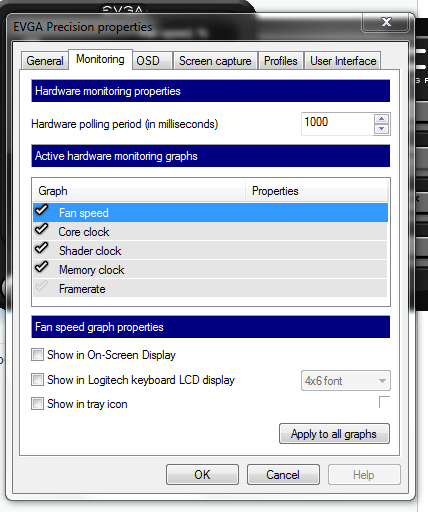

       #344
    Thanks but I don't seem to have a choice:
    sure I used to have.

    No idea why you would loose the option. I can see it was there in one of the screens you posted, very weird.
    Try rebooting a few times. I lost the temp monitor option as well and at first blamed it on the Beta 190.38's since it did not happen when I ws using the WHQLs. Although I knew the only real difference should be the WHQL stamp. Anyway I fllip-flopped between the 185.85's and 190.38's a few times. Then I lost temp monitoring again this time using the 190.38 WHQL's. Well to my surprise temp monitoring option came back after I rebooted once or twice.
    As you know Nvidia did away with the forced reboot at the end of the driver install in the 186.14 and 190.38 driver sets so I must not have rebooted the first time I tried the Betas and also during one of the WHQL installs. Perhaps Nvidia should have let the forced reboot in place.
    If the reboot doesn't work you may just wish to exit EVGA Precison Tuner, restart is then hit the Reset All button on the right ...

    Thanks HonestJohn. I just checked and you are right, the temp monitor is back (190.40)
    Still, odd and it must be these 190 drivers. It's never happened before.
