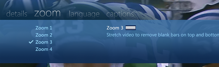

    When you are running Windows Media Center, right click on the playback screen and select ZOOM. Select the box that will fill the screen for you.
    Zoom 1 - Normal aspect ratio
    Zoom 2 - Stretch video to remove blank bars on sides
    Zoom 3 - Stretch video to remove blank bars on top and bottom
    Zoom 4 - Dynamically stretch video to maintain aspect ratio in the middle of the screen.
    If you have blank bars on the side of your screen, then you are using Zoom 1 and watching a program that is NOT widescreen format (16x9). You would want to use either Zoom 2 or Zoom 4.
