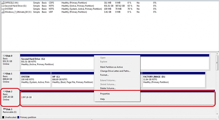

Below is the screenshot of disk management you posted. I an assuming the dropdown menu shown is for the drive in question. Click the one labeled change drive letter or path, in the next dialog box that opens, click add. You will be given a drive letter to use or you can select a different one. choose a drive letter.
