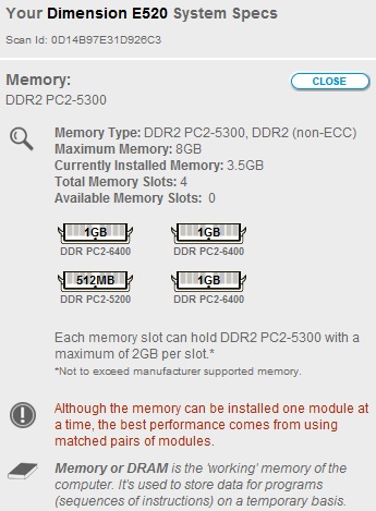

    i have scanned with crucial's memory scanner.
    "the best performance comes from using matched pairs of modules", does this mean that having same DDR's will have its maximum performance?

    I'm puzzled. Your information shows some very odd and seemingly unacceptable or contradictory details.
    Are you "overclocking"??
    (1) That screenshot shows you to currently have 3.5GB of PC2-6400 memory installed. That is 800Mhz memory.
    According to the Dell Dimension E520 Owner's Manual, your machine supports a max of 4GB of memory, not the 8GB maximum shown in that screenshot.
    I've checked the Crucial web site directly for the Dell E520 and it certainly does show that 8GB is the maximum supported by the machine, but that seems incorrect since the Dell manual says only 4GB max is supported.
    (2) Also, according to page 69 of that Dell owner's manual which describes the memory, and the machine specs on page 109, only 553Mhz or 667Mhz memory is supported. It does not show that 800Mhz memory is supported.
    Type 533-MHz and 667-MHz dual DDR2 unbuffered SDRAM
    Memory connectors four
    Memory capacities 256 MB, 512 MB, or 1 GB non-ECC
    Minimum memory 256 MB
    Maximum memory 4 GB
    Of course it would provide better performance to have 667Mhz memory installed (expecially since the price is so cheap) rather than 553Mhz memory, so given a choice choice I'd definitely recommend 667Mhz memory. But this would be PC2-5300 memory (sometimes named DDR2-667), not PC2-6400 as you show currently installed.
    Have you installed your own "upgraded" memory sticks, sometime after you purchased your Dell E520? Or did the machine come from Dell that way, with PC2-6400 800Mhz memory already installed? The 3.5GB total currently present is certainly an unusual, kind of non-standard number.
    Maximum memory 4 GB
    (3) Just to be absolutely sure of what you're really running, can you please please download and install CPUID (sometimes referred to as CPU-Z, which was its old name), run it, and post the results of looking at the SPD tab for all four slots of memory you've got installed.
    Nevertheless, as is shown on page 69 of the Dell manual:
    DDR2 Memory Overview
    DDR2 memory modules should be installed in pairs of matched memory size, speed, and technology. If the DDR2 memory modules are not installed in matched pairs, the computer will continue to operate, but with a slight reduction in performance.

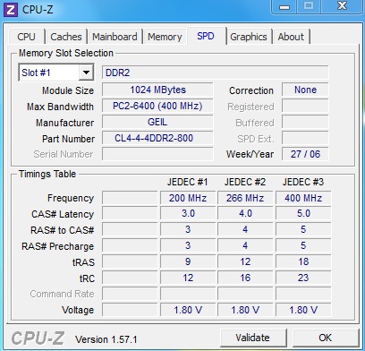

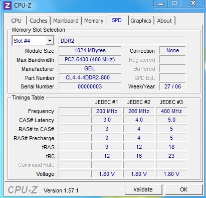

    when i bought it 2nd hand, yes i installed my own RAM.
    i have 2 questions?
    1.In my case, is having 3GB RAM faster than 3.5GB?(i have a feeling that taking my 512mb ram out will be better)
    2.When i have 4 RAM slots, but only decide to use 3 slots leaving 1 remaining, is it faster? i heard my friend saying that if i use all slots, then the motherboard uses more effort.
    thank you!
    Attached Thumbnails Attached Thumbnails [Major Problem] Attempted to add additional RAM, but fail to startup.-untit2led.jpg   [Major Problem] Attempted to add additional RAM, but fail to startup.-untitl4d.jpg   [Major Problem] Attempted to add additional RAM, but fail to startup.-untitle34d.jpg   [Major Problem] Attempted to add additional RAM, but fail to startup.-untitled.jpg
    Well apparently it's been working, with three out of four slots filled with three identical 1GB 800Mhz memory cards and the remaining fourth slot holding what I guess is a 512MB 553Mhz (or a bit slower?) memory card.
    However as I understand things, all of the memory would be SLOWED DOWN BY THE BIOS to conform to the slowest memory present. So I don't think you've been getting the performance you'd hoped for with those three "fast" cards. You've actually been getting the performance of those three cards limited by the slowest card, i.e. the 512MB fourth card.
    Again, 800Mhz is faster than Dell says the machine can support... although apparently it's physically working. But this may be because you actually have that slow fourth card, so this may be what has "saved" you in the first place. Don't really know, but it's really not right.
    My recommendation is to spend $64 and buy this 2x2GB kit from Crucial which is guaranteed to be perfect for your Dell XPS E520, and which will be the proper 667Mhz faster memory that Dell states is supported by your machine.
    Remove all four of your current memory cards, and place these two 2GB cards in slots 1 and 2 of the machine. This will give you the 4GB you want, in just two matched memory cards... and at the fastest speed Dell states can be used.
    i have 2 questions?
    I wouldn't spend much time trying to argue one way or another.
    My honest recommendation is to spend $64 and be done with it. Toss your current four memory cards and replace them with the two new ones from Crucial. 4GB is better than either 3.5GB or 3GB. And, your machine's memory will actually be running at the max 667Mhz speed it can run at, rather than the 553Mhz it is currently probably running at because that's the slowest card of your four.
    Well.. "more effort" is not really an appropriate description.
    But personally I would NEVER not use pairs of matched memory cards in pairs of memory slots. Also, I would fill either 2 or 4 memory slots, and never 3.
