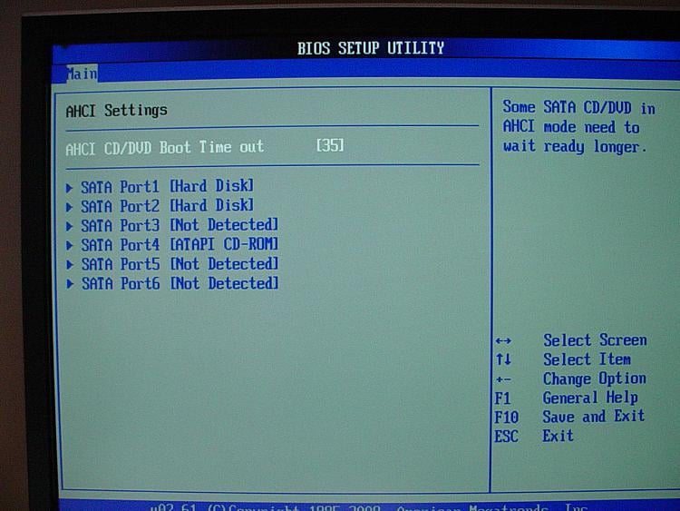

    Hi everyone. I've been following the thread to learn. I have not worked with an AWARD BIOS since the modern SATA MBs came out, so I am a true NEWB on this subject.
    But one thing has been bothering me throughout: Is it normal in a Award BIOS to have SATA disks listed as Master/Slaves as in photo 1 below if you have the Intel Controller in AHCI mode?
    In my AMI BIOS if the controller is set to AHCI mode then the disks show up as SATA Ports 1 through 6 as in photo 2 below.
    If I set the controller to IDE mode then the disks show as IDE CHANNELS, not SATA Ports. I can't remember if there is any Master/Slave designation.
    I only mention this because if this were not normal AWARD behavior, it might indicate a problem with the controller or the BIOS.
    Attached Thumbnails Attached Thumbnails My first solid state.-30082011724.jpg   My first solid state.-bios-003.jpg

    No, my drives in AHCI are not listed during the IDE section of the POST...they are only listed later on in a screen showing AHCI connected devices. As for in the BIOS itself, I don't think mine show as IDE devices, but I will have to verify when I get home.

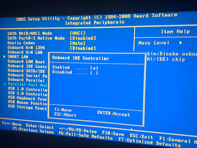

    Ok iv done the AHCI tweak.
    Here how is look like now,do you see anything wrong?
    Also what to do with the Onboard IDE Controller? Enable or Disable?
    Attached Thumbnails Attached Thumbnails My first solid state.-capture.png   My first solid state.-.png   My first solid state.-30082011732.jpg   My first solid state.-30082011731.jpg

    I'm not familiar with gigabyte boards, but I would disable on board IDE controller and on board sata/IDE controller set to ahci.

    In your screenshots, the Controller Mode is still set to IDE. That should have an AHCI option as well.
    As for the drivers, they are right on Gigabyte's driver page for your board. Download them and extract them...then have them handy on a flash drive during the install. You'll come to a point where you are shown your hard drive and given the option to load other drivers. Have the flash drive in and choose that option.
    GIGABYTE - Motherboard - Socket 775 - GA-X38-DS4 (rev. 1.0)
    All you have to do is choose Windows 7 x64 and it will be the last driver on the page.
    Ok i will do it now,well for 100th time restarting.........
