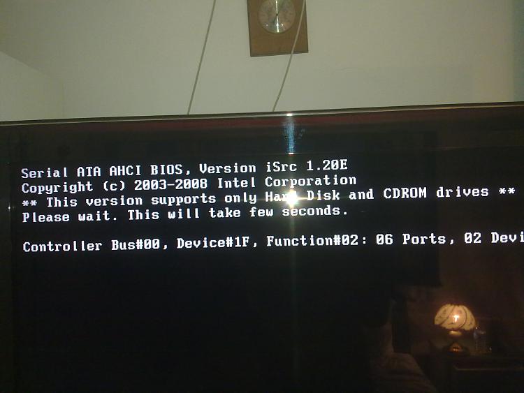

    In AHCI freeze in post.
    What is the sata port0-3 native mode anyway?

    Well i have done everything step by step,biosAHCI,installing windows,updates,programs etc.
    First,after each setup and step i backup with windows image.
    Then when i ifinish i installed my norton ghost 15,do some changes and then run the ghost recovery cd to test and the results was this,(creenshot)
    I could not enter bios,so i remove the motherboard battery,install again the battery,enter bios set it to ide and is start fine,set it to AHCI freeze in POST (screenshot)
    Attached Thumbnails Attached Thumbnails My first solid state.-31082011736.jpg

    Deacon may be right, but I thought Native was IDE. But, Panais, are the options only enabled or disabled or do you have other options?
  10. Posts : 5,405
    Windows 7 Ultimate 64bit SP1
    Thread Starter
       #150
    In sata port0-3 native mode i have only Enable or disable.
    Now i set it to enable.
