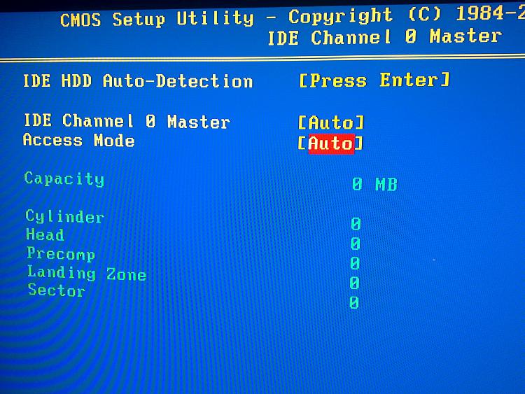

Ok i have done the above steps and i think we eliminate the first error message?
But now,What is that??? I get this message then windows start normally.
Well i thing i will.....
""I will enable the first in the list, the SATA RAID\ANCI i wil set it to ANCI""
""And i wil disable the ninth in the list,the Onboard SATA/IDE Ctrl Mode i will set it to IDE because there is not any disable option on that..""
And i will reinstall the windows!! I believe THE FIRST TIME i enable the wrong ANCI.
ANY ADVICE BEFORE I START THE REINSTALLATION?

29 Aug 2011   #64
pparks1
No, that looks good. Exactly what I see on my machines.
My System SpecsSystem Spec
29 Aug 2011   #65
DeaconFrost
That's exactly how it looks on my Gigabyte board. FYI, it's AHCI. I know the font Gigabyte uses isn't the easiest to read.

Quote   Quote: Originally Posted by pparks1 View Post
""No, that looks good. Exactly what I see on my machines.""
Really? You mean everybody with SSD\ANCI have the same message in POST??
Or is just a Gigabyte thing???
I had enable the wrong ANCI though so i will start again in a minute the format\installation in my new ssd.
And i hope i will be happy with my ocz vertex! I hope!!
A! give me a minute i have some new screenshots from my bios.

Wishmaster
Yes, that is what it looks like when AHCI posts.
Perfectly normal.

29 Aug 2011   #68
panais
Windows 7 Ultimate 64bit SP1
Quote   Quote: Originally Posted by Wishmaster View Post
Perfectly normal.
Please check well all the screenshots and tell me if you see anything wrong in this settings,or anything you dont like it!
This is how its look like now!!

Wishmaster
The only thing I can think of ATM that may be worth mentioning ...
Some Motherboards, if AHCI is enabled, will not boot from a CD if there is a OS installed on the system.
Even if it is set to CD/DVD as first boot device.
If yours does this:
On a Gigabyte board, when the motherboard splash screen comes up, just press F12 (I think it is .. please confirm) for a Advanced Boot screen.
Select CD/DVD drive and it will then boot from the CD/DVD.
Not all boards require this, just thought it was worth mentioning in case you decide to re-install from scratch and the Win7 DVD will not boot.
You'll know how to proceed.
