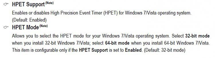

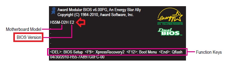

    Do you have the latest F3 BIOS version flashed for your motherboard? It's suppose to have "Improve memory compatibility" that may help with this.
    EDIT:
    You should have HPET Mode set to 64-bit mode since you have 64-bit Windows 7 installed.

    i have restarted my computer and it says h55m-d2h F2
    That indicates that you have the older F2 version flashed. If you would like to flash your BIOS to the latest F3 version, you can get it at the link below. Once you download the self extracting EXE file, run the EXE file to extract the contents to your desktop. The h55md2h.f3 file is your BIOS file. If you read starting at page 64 in your motherboard's manual (click on link) for Q-Flash. It will give you details on how to flash your motherboard with Q-Flash. If you do not have a USB key to put the extracted files on to use with Q-Flash, then you could just manually navigate to and select the h55md2h.f3 file on your desktop while in Q-Flash.
    GIGABYTE - Motherboard - Socket 1156 - GA-H55M-D2H (rev. 1.3)
       Warning
    Be sure that you do exactly as the manual says. One mistake could make a dead brick out of your motherboard. If you are not comfortable doing this, then it would be best not to do so to avoid the risk.
