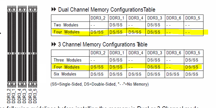

I believe your memory configuration is not allowable by the Motherboard.
After reading the Manual -> The memory can only be in either dual or triple channel mode. From reading, it seems your dual channel memory is being detected and used but not the tri channel 3 x 1GB sticks.
There is a table in the manual as to how it can be set up -> page 16.
Basically, consult the manual link above and setup your memory accordingly.
I'd recommend 4 sticks in dual channel so 2x1GB and 2x2GB giving you 6GB usage. Your spare stick will have to find another home

You do not need to flash your BIOS, just leave that alone.
You may need to install the RAM in one of the configurations shown in the manual (see below).
But you could try populating DDR3_1 - DDR3_3 - DDR3_5 with the 1GB modules
and populating DDR3_2 - DDR3_4 with the 2GB modules to test.
Otherwise, use just 4 modules as chessdragon136 suggests, or buy another 2GB module to make it an even 6. (But the three 2GB modules really should be a matched set to avoid further issues).
