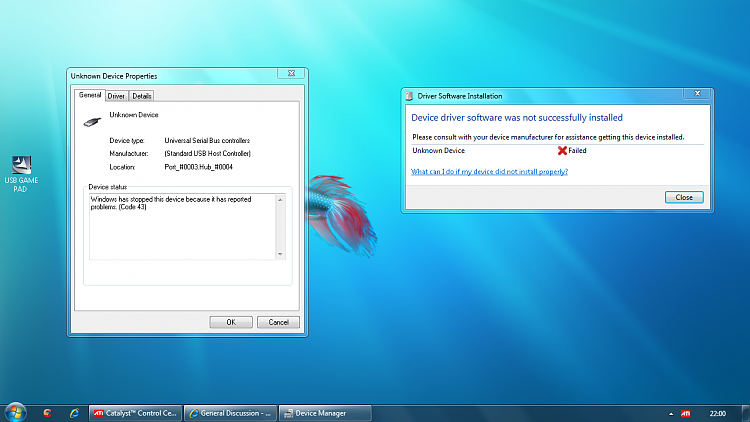

    usb not working
    my usb game pad isnt working and need to know if its the actual gamepads error or something else or any diagnostic ways of fixing this error
    ^heres the errors im getting
    ive tried all the simple solution like uninstalling rebooting etc
    is there any more advanced trick s
    help would be ma-who-sively appreciated
    its the game pad (USB) driver. Not installed correctly

    squonksc said:
    Like always we need some more info.
    1. What brand/type gamepad?
    2. do other USB devices work ok?
    3. What driver are you using for the gamepad? Version and intended OS?
    4. Have you tried other USB ports?
    5. Are you connecting it to a USB hub, or directly in the computer?
    Oh, by the way, you made a typo in your specs. It says 60 watts PSU, I think that must be 600, right?
    Greetz
    its just a cheap anologue from game but cant find it in there store to post link even though i only had it couple of weeks
    other usb devices work
    i was using the driver what came with pad but windows 7 recognized it straight away and worked withought the driver cd
    yes ive tried different usb ports and a laptop with windows 7 onit with same results
    im thinking its fooked, but thought id see if theres a solution first...
    it was working fine
    then all i did was download game booster preparing for some serious gaming .then this happened.
    p.s. i dont have restore point
