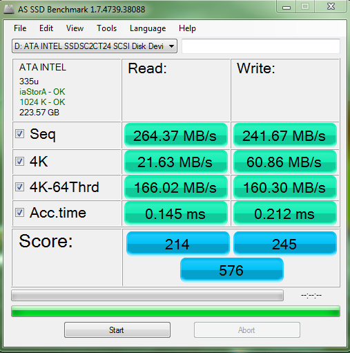

Numbers indicative of an Intel 335, I got about a month ago for apps, running on a SATA II mobo. Since the system does what I want it to, won't be upgrading the mobo simply to get full performance from the drive.

I would not bother upgrading the mobo. The access times will most likely not change and the data transfer rates are of a lesser importance. The difference would only show in the measurements but have very little impact on real life performance.
Precisely. I don't expect to be building a second system or upgrading this one for some time as it is all I need.
