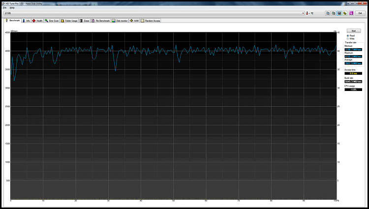

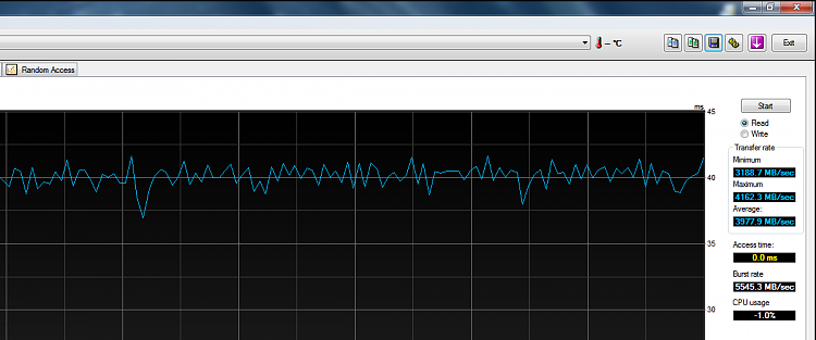

  5. Posts : 1,251
    Windows 7 x64 Home Premium
       #195
    [QUOTE=OppfinnarJocke;1893297]
    Hopalong X said:
    HD Tune is for bench marking HDD's/spinner hard drives not SSD's.
    My Copy of HD Tune 3.50 benchmarks both my SSD's and the 2GB RAM Disk...
    Attached Thumbnails Attached Thumbnails Show us your SSD performance 2-ram-disk-2012-4-23_.png   Show us your SSD performance 2-ram-disk-2012-4-23__.png
  6. Posts : 6,349
       #196
    [QUOTE=Maxxwire;1894139]
    OppfinnarJocke said:
    They were using v2.55.

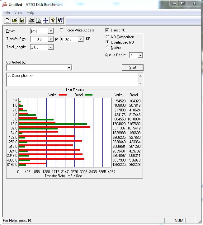

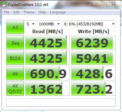

  7. Posts : 15
    Windows 7 x64
       #197
    RAM Disk
    RAM Disk performance
    Attached Thumbnails Attached Thumbnails Show us your SSD performance 2-anvil-bench.jpg   Show us your SSD performance 2-crystal-diskmark.jpg   Show us your SSD performance 2-atto.jpg
  8. Posts : 1,251
       #198
    From the HD Tune website versions list...
    '12 February 2008: HD Tune Pro released!
    HD Tune Pro is an extended version of HD Tune which includes many new features such as: write benchmark, secure erasing, AAM setting, folder usage view, disk monitor, command line parameters and file benchmark.
    Version 2.55 includes several minor improvements.'
    As I remember I used to have v2.55 before I upgraded to v3.5 about a year later.
  9. Posts : 1,251
       #199
    I've often noticed that the Crystal Disk measures significantly higher than HD Tune when benchmarking my 2GB RAM Disk.
    Attached Thumbnails Attached Thumbnails Show us your SSD performance 2-ramdisk_.png
  10. Posts : 15
    Windows 7 x64
       #200
    This was a 8GB RAM Disk tested last night. Would post some SSD scores but this PC only has SATA-II controllers for the HyperX SATA-III SSD. So it's nothing to write home about.
