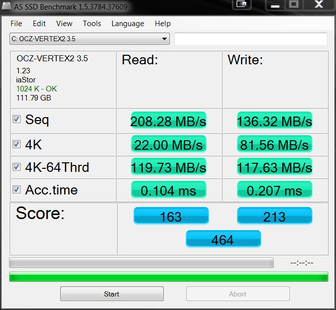

       #289
    128GB Vertex 2
    128GB Crucial C300
    128 Crucial M4
    240GB Intel 520
    I was going to Raid the intel drives, but figured they're fast enough without doing so.
  10. Posts : 12,177
       #290
    Nice upgrade.
    Any noticeable difference between the 128GB M4 and the 520?
    The 4k read and access times are slightly better on the M4 but, my guess is it's not a noticeable difference.
