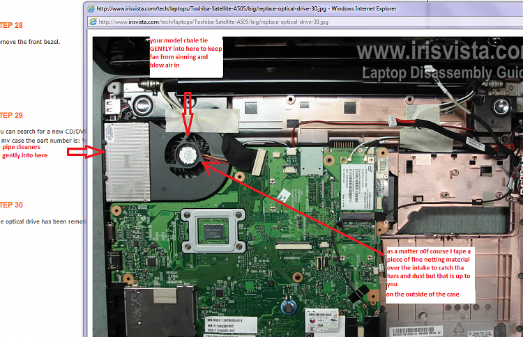

Seriously all you need is a multimeter a digital one very cheap these daysand plug the adaptor in and set the meter to say 100v on its dial put the twoprobes usually red and a black one to one of the adaptors output lead terminalsone to the other and see what the reading is. If it measures up at about 19v(typically) it is ok then then do the same on the battery terminals in thebattery bay and see if the supply is coming through.
Well just one thing you can do is overturn the machine onto its lid - shinea very bright light into that air intake where the small fan is and look to seeif there is a lot of dust on the fan. Then keeping the light source there lookinto the exhaust vents on the side of the machine and see if any light iscoming through that small radiator. If there is very litle light coming throughthen the cooing "rad" is blocked and the high temps will cause theCPU to shut itself down.
Now as for cleaning you can suck from the fan aperture using a vacuumcleaner and / or blow it with a can of compressed air - cheap to buy . Cleaningthe rad you can use pipe cleaners to GENTLY push the dust lose form the outside.
but one word of WARNING ifyou blow the air into that fan opening please place say the end of a cable tieinto the blades first because the compressed air will spin the fan at more thanit s designed speed and could wreck the bearing !!
To take it apart is easy for me and at a shop expensive for you take a lookat this
http://www.irisvista.com/tech/laptops/Toshiba-Satellite-A505/removing-optical-drive-1.htm
In the pics the rad and heatsinks are from another model but most are fairly similar and typical
The CPU temp I should myself like to see below 5-C at least when you run Speccy.
toshiba satellite a500-18x turns off while gaming-fan.png   toshiba satellite a500-18x turns off while gaming-fan2.png
