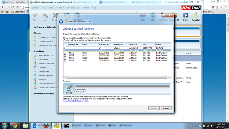

    You guys are great, thanks for the support. Alright before doing anything wrong, here is what I have right now. I can only check two of the partitions. Should I click finish anyway ?
    I have no doubt Jumanji is more than competent to walk me through the recovery of my data. The only reason I was looking at other softwares is that I had stored on the HDD some files with very uncommon format. Mostly data sets which were created by specific statistical analysis programs. From what I understand I am not sure those could be recovered easily ...
    Attached Thumbnails Attached Thumbnails External HDD suddenly requires formatting, read as RAW instead of ntfs-before-doing-anything-wrong.png

    In your previous screenshot all the six partitions are unchecked. Four of them showing as boot say lost/deleted.
    When you put checkmarks on the the first two, do all those four boots turn to show as overlapped?(That would mean we are unable to get back to the original condition) If it is so and you are unable to put checkmarks on those four, then cancel the operation.
    Get on to PhotoRec .
