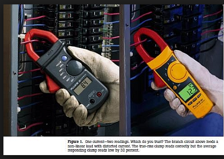

  7. Posts : 21,007
       #57
    madcratebuilder said:
    Voltage is only part of the psu output equation. You have to know what it is putting out in current, or amps. A psu may test with good voltage readings but fail on amp output causing all sorts of problems. You can test for amps with a multimeter but it well require a shunt. Good meters may have a internal shunt capable of up to 10 amps or so, but nothing close to what a pc psu can supply. Having a "test" psu available can save hours of troubleshooting. It doesn't need to be a real expensive high end unit, several good options in the sub $50 area.
    Which is what I have been saying all along Mad and yes I have had some more expensive multimeters that will read up to 20A in DC and 10A in AC. There are to ones that do "clamp" around the cable but are usually quite expensive and not what we would probably want for our purposes because they measure AC current only How does a dc clampmeter work? | Electrotechnik - The Website on Electrical Engineering
