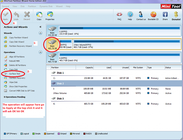

    You have done well so far.
    Now download Minitools Partition Wizard Home Edition referenced by ICit2lol in post #2. Install and run it. Post a screenshot. If your problem drive shows up a bad disk, the prognosis is indeed bad.

    I've Had the drive for 18 months no warranty. I do have stuff i would like to keep but if i have to format it it doesn't worry me to much.
    WD Ext HDD 1021 2TB Hard drive stopped working-mini-tool-partition-wizard.png

    As I feared, PW is showing your HDD as Bad Disk.

    Well my two cents again what about a surface test with Partition Wizard?? At leasst it might eliminate any physical damage.
    Attached Thumbnails Attached Thumbnails WD Ext HDD 1021 2TB Hard drive stopped working-test.png

    It says disk is error: write protected I think i will just go get a new drive and throw this on in the bin thanks everyone for your help it been greatly appreciated jumunji i hope your help gets better thanks again for your help
