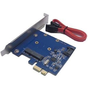

    thanks badger. No, the PCIe card has only 1 slot (where the cable plugs in) so the SSD is the only thing plugged to it--the SSD as you know has a thing, a space, for the red cable which goes to the PCIe card and another longer space for the power. the power cable of the PC is plugged into it--this same power cable shares it with another (There's a big power cable that comes out of the power bar and this cable has 2 plugs).
    The card is this one: mSATA SATA III 3.0 HDD SSD to PCI-e HyperDuo Raid Controller Card Adapter 6Gbps
    and looks like this (See attachment)..
    We need the exact model of the card if possible please. and your hdd will not show up unless clicking scan for devices because your sata port your using is not set up to be hot swapable. in bios it will say something like make this an external device then in windows you can make that port set up for quick removal.

    If you see the photo attached here I wrote A and B. On my PC there are 3 'A' which are unused knowing they are not made for the SATA and one 'B'. and I think this is what you meant. As to the exact model of the card (assuming it's the PCIe card since the MB was given is as I wrote it above. There is absolutely nothing written on the card itself--it is not a name brand. If it helps I've added a Belarc Advisor report showing my specs. (Oh except the photo shows the sata as male and what I have is female--the one originally attached to my HD where the OS was)
