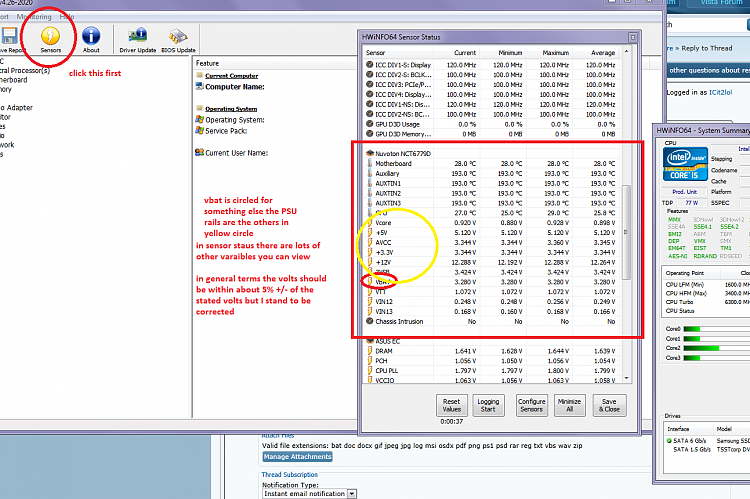

    Ok mate I still think the readout you got before was low for what you have you might try a rerun with it and make sure everything is put in - some of it is pretty technical and some stuff it seems irrelevant I know but worth looking at.
    If you want to keep an eye on the volts from the new PSU and other stuff in the machine run HW Info HWiNFO, HWiNFO32/64 - Download < get the right bit version > close the right hand window and click on Sensors > scroll down the window that opens and check the volts.
    The other devices can be viewed by opening them out in the left hand side window see my pics.

    Thanks for mentioning about that software. I have sent the Corsair PSU for RMA and now I am using Antec VP550W. So far , system performed more than 4-5 cold boots. no issues so far. Can I say that graphics card is working fine?
