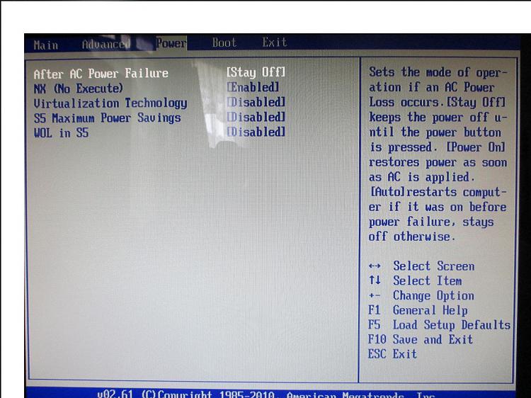

Sorry, I uploaded a file with the last correspondence - don't know what happened to it but I'll try again. Please remember also, that the message came up while the keyboard and mouse are inactive, so what I captured was with a camera. I am also going to send my BIOS power setting.

No problem what is the Error Code i can not see it proper ?
