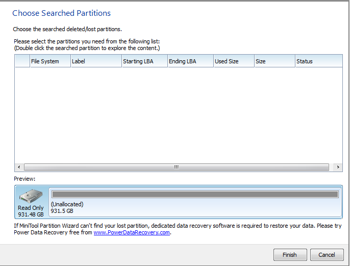

    Alright I just finished the scan.
    Here are the screenshot.
    I noticed that during the first 2 minutes the process was kinda slow, and the EXT hard disk's LED is beeping. As far as I know, it's a sign of activity inside the disk. Then suddenly, the process goes fast (as shown, it jumped right to 7%) and the LED light is no more beeping
    And the second screen shot shows there's no partition found. And I used the 'deep scan'. I've also tried "Quick Scan" and it shows the same thing.
    Oh man... ((((((
    Attached Thumbnails Attached Thumbnails WD EXTERNAL HARD DISK 1TB suddenly "unallocated" and "not initialized"-part-2-beeping-no.png   WD EXTERNAL HARD DISK 1TB suddenly "unallocated" and "not initialized"-part-3.png

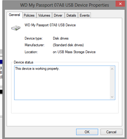

    In Disk Management, here is my status of my hard disk. It says the device is working properly
    Attached Thumbnails Attached Thumbnails WD EXTERNAL HARD DISK 1TB suddenly "unallocated" and "not initialized"-device.png

    OK, the Quick Scan completed but did not find any partition.
    Post a screenshot of how your disk looks in Windows Disk Management. I just want to see whether it is any different from what you posted earlier. Please make sure that you hide the console tree and Action Pane by clicking the Show/Hide buttons in the tool bar and present a full screen view.
