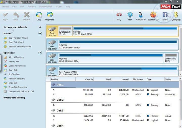

    Didn't work apparently. I double clicked on the first line (after filling check mark), and got the second screen. No contents, just 'Disk:2 LBA:2048'. Drive B is the one. Still 'RAW' in Manage.

    OK, for clarity's sake, post the screenshot of PW main screen again and then the screenshot of Windows Disk Management.( Please remove all other external drives)
    I presume that zero operations were pending and therefore you couldn't Apply.
    If you remember you ran check disk and it gave out a message that MFT is corrupted.
    Now repeat the same Check disk process.
    If you get the same MFT corrupted message and the cursor keeps blinking, it denotes check disk is running in the background. Do not abort. Allow check disk to complete which again will take a long time , perhaps as long as it took for PW Quick Scan.
    Let us see what message you get at the end.
    If check disk repairs the MFT well and good. If on the other hand it throws out a message could not repair and aborts itself ( my post #3), we shall then proceed to use TestDisk to repair the MFT.

    Yesterday, I started a demo of Active File Recovery for Windows (LSoft) and it's at 64% after about nine hours. I'll see what happens. FYI, I've attached a capture of the program scan screen in progress and the Signatures tab, which I assume is what it has found so far. The third is the Volumes tab.
    After Partition Wizard yesterday, btw, I recall getting an MFT corrupt message with chkdsk. In any case, I'm waiting for results of "Super Scan" with this other program. Thank you and will post back.
