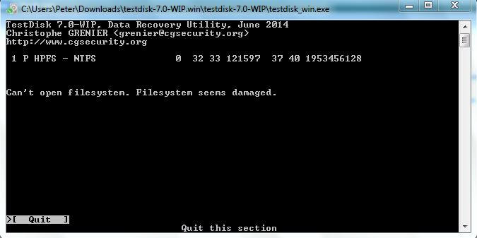

    If TestDisk starts scanning in its attempt to repair MFT, let it do it. Again it may take a long time.
  5. Posts : 108
    Windows 7 Pro 64bit
    Thread Starter
       #35
    Not a good sign :)
    Attached Thumbnails Attached Thumbnails Disk structure is corrupt and unreadable-capture.jpg
  6. Posts : 7,024
    Windows 7 Home Premium 32 bit
       #36
    That is bad luck. The mirror also is corrupted.
    So then data recovery is the only option. Quit Test Disk.

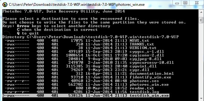

    At "11. Tenth Window" of the tutorial, the screen shows a line he has chosen for the destination that says "recovery". This is not among my choices. I quit photorec and put a folder in the testdisk folder named Recovery, but it does not show up when getting to the destination screen again. I need to figure out which choice to make.
    Guide to using PhotoRec recovery software.
    The screen captures are first visible portion of my choices and then the remainder further down after arrowing down.
    I would also like to know if the choices could be other than in the testdisk directory. I ask because if I choose .mp4, for example, the results (if most or all are found) would be huge and would not fit on C. It would have to be an external drive.
    Which also leads me to another question: will this program recover files that have been deleted over the past year? In which case, we're talking literally multiple terabytes.
    Attached Thumbnails Attached Thumbnails Disk structure is corrupt and unreadable-capture1.jpg   Disk structure is corrupt and unreadable-capture2.jpg
  8. Posts : 6,458
       #38
    While jumanji enjoys his dinner, I can answer some questions.
    Yes, the destination folder can be any directory/folder.
    I'm wondering if the Recovery folder you created wasn't one level up
    The only stipulation is that the folder is NOT on the same partition / volume as the data you are trying to recover. I'll go one further and state that it should be a separate drive, which I believe is the case for your recovery.
    Suggest creating a Recovery folder in your Downloads folder, not under Testdisk.
  9. Posts : 108
    Windows 7 Pro 64bit
    Thread Starter
       #39
    Unfamiliar with DOS navigation. How do I get to a destination other than testdisk folder? See my edited previous post with related questions about old deleted files, huge results etc.. Thanks.
    edit: never mind, used arrow keys to get to a folder I created on a USB drive. Question is: is it wise to have this USB drive connected while running the PhotoRec recovery? Again, need to mention that my results for video files (if found) will be gigantic, too large for space on C, only an external drive.

  10. Posts : 7,024
       #40
    By way of some explanation,
    In the subject guide I created a Recovery folder on one of the partitions H on my internal drive ( Which shows up as drive H) and then navigated to it.
    I know it is a bit difficult to navigate till you get a grip on it.
    When this question was raised by a OP who used TestDisk I wrote this post My external hard drive suddenly became unllocated:
    You will now be using an external drive to copy the files. It is optional to create a Recovery folder in it ( Which you should before you started PhotoRec) but preferable, to segregate it in case you have other data present on the external drive.
    Depending upon whether you created such a folder on the external drive, you will navigate to that external drive or go one step ahead and into that folder on that external drive.
    Screenshot 7 onwards in the above referredd post should guide you on how to navigate to that external drive/Recovery folder in that external drive. ( Don't look at Screenshots 1 to 6 :). Those pertain to TestDisk.)
    Once you have the basic idea you can play around with the arrow keys and feel how it takes you everywhere.:)
