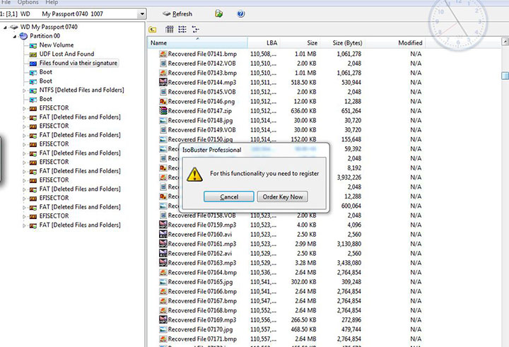

    Yes, the .vob extraction thing (that started I think with v3.3) is what made me try it. The product came up when I Googled something like "recover .vob files".
    I've just noticed a running file ticker (scanned number of files and total to be scanned) down at the bottom that also is flashing file extensions in quick succession as it comes across them (.vob, mp4, avi etc.), so that's encouraging. That nothing is showing up in the file tree yet, however, is not. It has a pretty comprehensive Help which, as usual, I haven't looked over much.

    So, finished but need to buy it to go further. I think I will. Going back to photorec to try some more stuff there first.
    Attached Thumbnails Attached Thumbnails Disk structure is corrupt and unreadable-capture.jpg

    If you could, that'd be great. But, I'm going to get Isobuster anyway because it has the option of extracting results individually. I believe PhotoRec results would be to extract all to a directory as the only option and currently I just don't have the space.
