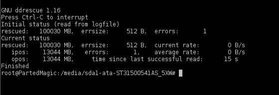

    Let's start the cloning process with "ddrescue". A typical "ddrescue" command line format will be like this ;
    ddrescue <source disK> <destination disk> <log file>
    Log file is optional but it will provide resume functionality. The screenshot you uploaded shows following info.
    /dev/sda is the 500 GB sized source disk.
    /dev/sdb is the 2000 GB sized destination drive.
    /dev/sdc is the USB flash drive. It is mounted on the mount point /media/sdc1. Mount point is similar to drive letters on Windows. Just like we need to access partitions through drive letters in Windows, we access partitions in Linux via mount points.
    Now open a terminal Window and enter the below command exactly.
    ddrescue -d -f -r3 /dev/sda /dev/sdb /media/sdc1/recovery.log
    You will see a Window similar to the below example.
    Depending on the level of surface damage, it may take several hours to complete the cloning. When the last time i used "ddrescue" to clone a 500 Gb HDD with lot of bad sectors, it took almost one day to rescue as much as readable sectors. So wait patiently until it shows the "finished" message and then post a screenshot of the active window.
    Btw, if "Time since last successful read" shows more than 3 hours, it means the cloning process hanged. In that case, press "ctrl + c" to abort the cloning and post a screenshot of the window.

  9. Posts : 74
    Windows 7 Home Premium 32 bit
    Thread Starter
       #159
    so after about 10 hours.... the screen changed to this... it looks like it started over???
    Attached Thumbnails Attached Thumbnails how do I recover data from a non responsive hard drive?-screenshot-retry-1.png
  10. Posts : 74
    Thread Starter
       #160
    when I last looked at it, the ipos: and opos: were both close to 500000 MB
