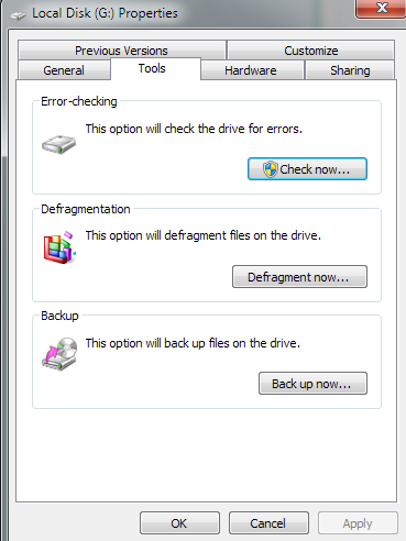

    The new disk is indeed "RAW" in Disk Management. Is the CHKDSK the "Error-checking" tool accessible from "properties"?
    Seagate 2TB Hard Drive not responding, stops programs from working-capture2.png
