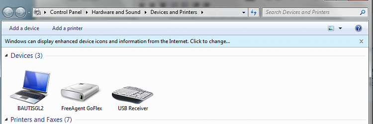

    EDIT: The drive can be seen in the Devices and Printers as shown below.
