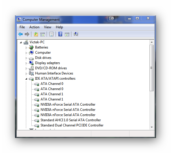

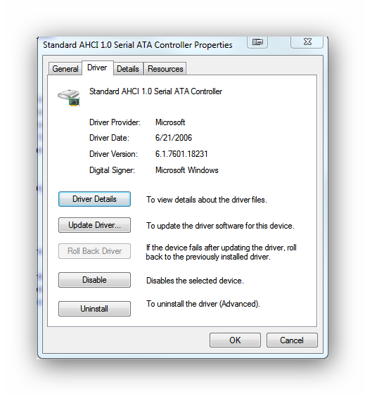

    Although there's no AHCI option in the BIOS I do have an AHCI entry in the Device Manager:
    Attached Thumbnails Attached Thumbnails SSD Upgrade questions-ashampoo_snap_2014.06.24_21h15m49s_005_.png   SSD Upgrade questions-ashampoo_snap_2014.06.24_21h21m37s_006_.png

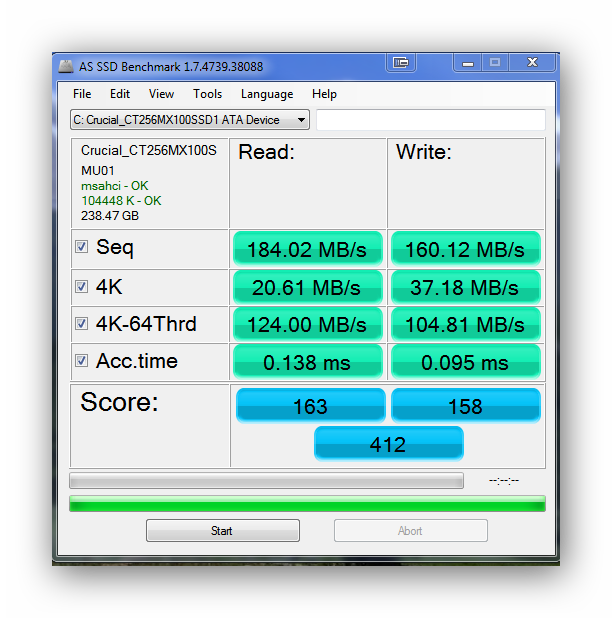

       #20
    Britton30 said:
    If you swap SATA headers you may need to tell BIOS it is the boot device.
    Thanks for that. Here are a couple of screenshots of what's going on now. I don't know if it's better/worse/the same :) I hunted around for a JMicron specific SATA driver and found a few possibilities, but haven't been able to ID the embedded controller precisely yet. Any additional suggestions will be appreciated.
    Attached Thumbnails Attached Thumbnails SSD Upgrade questions-ashampoo_snap_2014.06.25_07h44m03s_001_.png   SSD Upgrade questions-ashampoo_snap_2014.06.25_07h44m18s_002_.png
