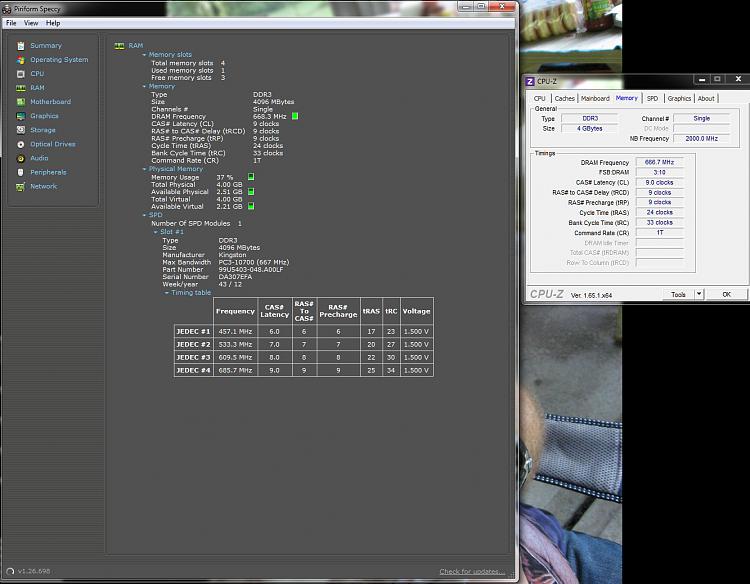

    Test results
    There is something very odd going on, it seems.
    Same stick of RAM for the memtest screenshots and the single-stick reports from Speccy/CPU-Z.
    In slots 1-3, memtest86+ reports 666 MHz, 9-9-9-24
    In slot 4 (same RAM stick), 200 MHz, 9-9-9-24
    If I have RAM in 1 or 2 slots (any 1 or 2 slots) I get 666 MHz, 9-9-9-24 from CPU-Z.
    But if I have 3 or more (anywhere) it shows 533 MHz, 7-7-7-20.
    Weird, huh?
    Not conclusive, but no BSOD in the day and a half or so I was running with RAM only in slots 1 and 2.
    Thanks for the help.
    Attached Thumbnails Attached Thumbnails memtest86+ showing different speeds for memory slots-ram_memtest_s1-3.jpg   memtest86+ showing different speeds for memory slots-ram_memtest_s4.jpg   memtest86+ showing different speeds for memory slots-ram_s1.jpg   memtest86+ showing different speeds for memory slots-ram_s1-s2.jpg   memtest86+ showing different speeds for memory slots-ram_s1-s2-s3.jpg
    memtest86+ showing different speeds for memory slots-ram_s1-s2-s4.jpg   memtest86+ showing different speeds for memory slots-ram_s2.jpg   memtest86+ showing different speeds for memory slots-ram_s3.jpg   memtest86+ showing different speeds for memory slots-ram_s4.jpg

    Nice screen shots.
    I do not see anything wrong with the RAM. You have a matched set of 4 modules and they all match in timings and every other spec. If I were going to bet, I would bet that the RAM is OK.
