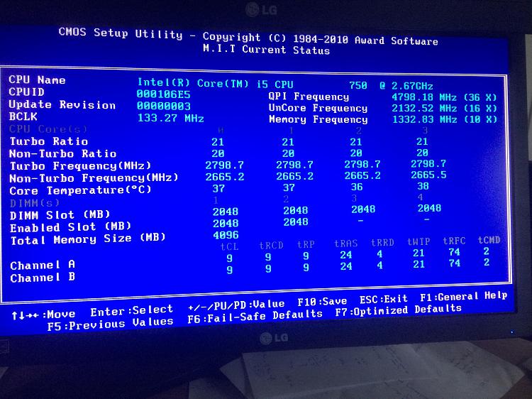

    Well, 19 passes while I drank beer and no errors. Bill please see attached..
    Think I was trying to update the BIOS incorrectly, I think I need to put it on a CD and boot from that? Also I would like to back up my current BIOS first.. Could someone recommend a way to do that please?

    Check your motherboard manual, some have a dual BIOS which keeps one in its ROM chip.
    There are several suggestions here you should try too. One step at a time.

    I've got to go out but will look at this later, here are some other random snaps of my BIOS for the meantime. I couldn't find XMP in there... Also, should that 32-bit be changed to 64-bit because I have Windows 64-bit?
    Attached Thumbnails Attached Thumbnails Can see 8gb in BIOS, but only 4 useable-img_0563.jpg   Can see 8gb in BIOS, but only 4 useable-img_0564.jpg   Can see 8gb in BIOS, but only 4 useable-img_0565.jpg   Can see 8gb in BIOS, but only 4 useable-img_0566.jpg
  7. Posts : 24,479
    Windows 7 Ultimate X64 SP1
       #27
    XMP may be listed under the MIT section, it's considered overclocking.
    The HPET is High Precision Event Timer and 32 bit is fine.
