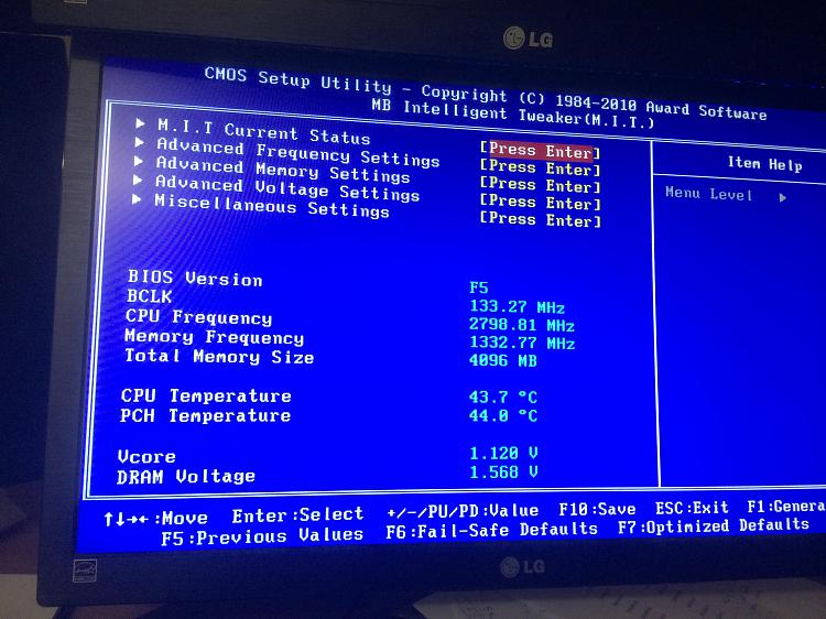

    Hi there, I've done some reading and apparently I need to enable 'memory remap feature' in BIOS, but I cannot see it anywhere in the BIOS.
    Please see photos/screeny attached and see if it makes any sense..
    mobo: GA-P55A-UD3
    8 X 2GB RAM
    Attached Thumbnails Attached Thumbnails Can see 8gb in BIOS, but only 4 useable-device.jpg   Can see 8gb in BIOS, but only 4 useable-img_0540.jpg   Can see 8gb in BIOS, but only 4 useable-img_0541.jpg
  2. Posts : 1,686
       #2
    Hi Nolube and welcome to Seven forums. From what I can see from the screen shots of your bios you have 8 GB ram installed. The system is disabling 4g of it as the first screen shot states 4096 Mb as the total ram. 2 of your slots are not enabled. Try removing and reseating the ram (with the power off). Check in the BIOS if there is a setting to enable or disable the second ram channel.

    After following Indiantone's instructions, you might try resetting BIOS
    F6: Fail-safe defaults
    or
    F7: optimized defaults

    You may find the setting under MIT, Advanced Memory Settings.

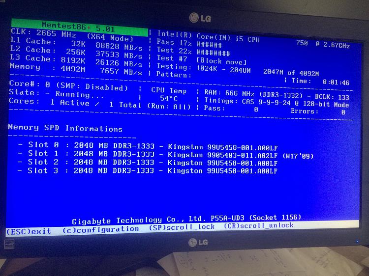

    Yes I tried resetting to default fail safe, also optimised default. Just running the ram checker now.

    Let it run for the full 8 passes, unless you get any error, red lines at the bottom. If errors then go the single stick in each slot.
    It shouldn't make a different, but Slot 1 RAM has a different part number unless it's a glitch in memtest.
