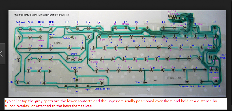

As Mellon Head has said mate but some can be pulled apart and the contacts cleaned. It is a matter of prising off the key pads and underneath there are rubberised electrical contacts that in your case have become contaminated by say sugar if the liquid was coffee or what.
Now depending on how much grief you want to go to - do as Mellon Head has said and just replace it and you can disassemble it for an exercise afterwards if you want to and you will see what I mean.
Edit: The pic is actually in reveerse you need to see that as the other way round
