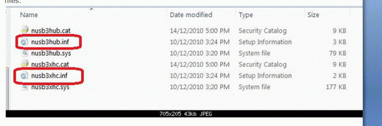

    I saw on another forum that I need to load the USB 3 Host Controller andHub drivers at the beginning of the restore process (screenshot below) and the computer should then pick up the image. Is this correct? Is it normal to do this for any external hard drive? I've always used DVDs for system images and the computer recognises those straight away.

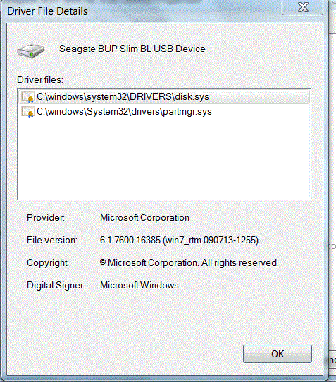

    The SEH works on all USBs. It is some months ago now I tried to run the system image but I do remember at that time trying all the ports thinking that one of them maybe playing up but the computer could not see the system image on the SEH no matter what port I tried. I'm pretty sure there's nothing wrong with the USB ports, they all work OK for all other devices. In fact, they work for the SEH, I can see all my docs/music etc on it and the windows image I created. It shows up in device manager too (as below).
    I don't have the Seagate Maxtor programme, not sure what that is.
    I'm a bit nervous about uninstalling a USB port. I looked at the USBs under disc management - with the SEH plugged in - but there was no clue as to which one it was plugged into. I've gone into device and printers and it says the drivers are up to date (I purchased the SEH about April time this year).
    So, as far as I can see the computer is recognising the SEH, but is not able to see the image when I'm trying to run a system image.
