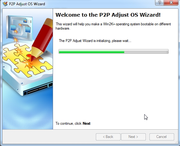

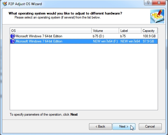

    If you were attempting to transfer your current os to different hardware, it should be sysprepped. But it probably wont work just by being sysprepped because there is also lack of csm support and missing drivers to overcome.
    You could only sysprep the applied image if you can boot into it. Cant be done from outside as far as I know. However there are 3rd party "adjust to new hardware" tools that can be used without booting into the os.
    for example this one

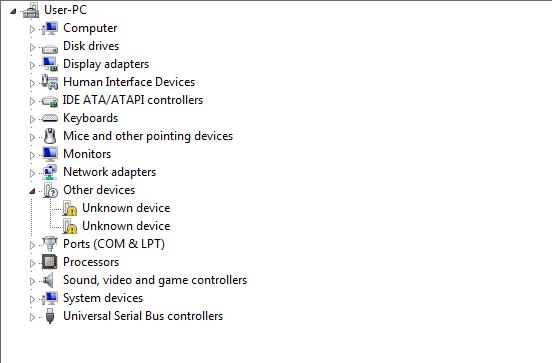

    I just applied the 3888 image to a consumer b365 motherboard. After fixing the osletter it booted up fine, then after a reboot only a couple of drivers missing which was easy to sort out. Not necessary to use "adjust to new hardware module" in that case.
    But applying the 3671 image to b375 consumer motherboard got stuck on the dancing balls, so adjust to new hardware module was needed.

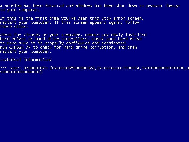

    Dancing balls, love it! That's where 3888 would crash for me and 3671 gets the following BSOD:
    Before I go any further, can you tell me if this is normal? When trying to do bootrec /rebuildbcd I was told no OS was detected. Then I noticed there is no boot folder on the C drive and no BCD (it does boot it just gives the BSOD during the dancing balls). This is what they look like:
    EFI drive
    EFI>
    Microsoft > Boot >
    BCD, bootmgfw.efi, bootmgr.efi, memtest.efi (and a bunch of language folders)
    Boot > bootx64.efi (757,760 bytes)
    C drive
    No boot folder
    Is this normal?
    Btw, what program is that for P2P OS Wizard? O&O or Paragon?
    Attached Thumbnails Attached Thumbnails How to make my Win7 OS drive work on new PC-tibx-bsod.png
