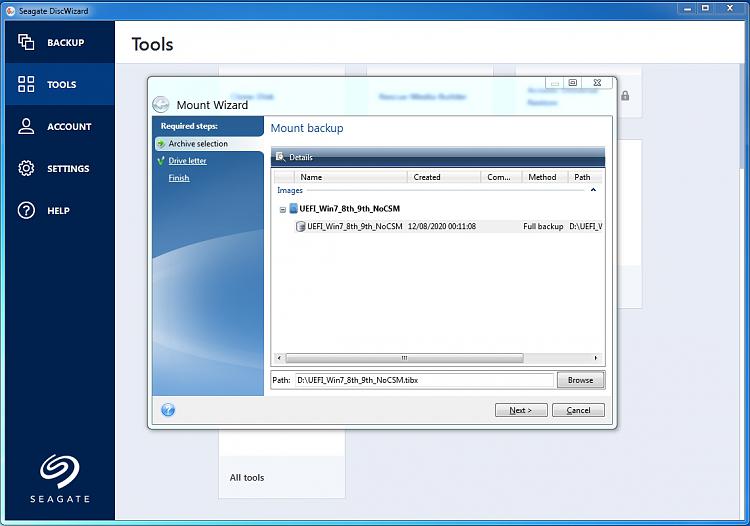

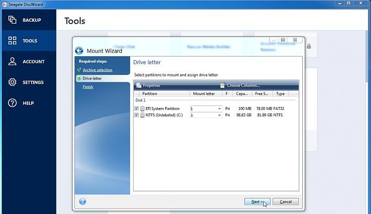

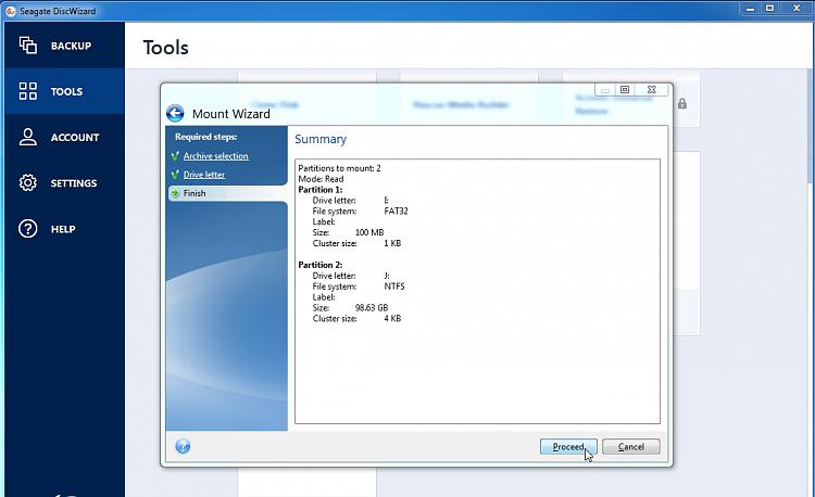

    I had a look at those .tibx images
    Used seagate discwizard to mount the .tibx image partitions and then captured the mounted partions into .wim files.
    [seagate discwizard is a free cut down Acronis but only works if you have a seagate disk attached. Western digital do a similar one which only works if you have a wd disk attached]
    It is then easy to apply the contents of the wim files onto a prepared esp partition and os partition. Then it is simple to adjust the osletter and fix the bcd entry before attemting to boot.
    If there is a bsod then p2p or similar can be used.
    After the partitions are mounted ( using letters I and J in the screenshot above ) capture partition I into a .wim
    Then capture partition J into a .wim file.
    Then unmount the partitions.

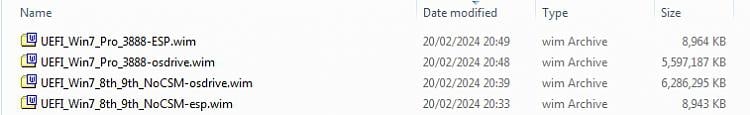

    Same with the other image. Here are the .wims
    I used wimlib command line tool to capture the mounted partitions,
    wimlib-imagex.exe capture SOURCE DestinationWIMFILE IMAGE_NAME [IMAGE_DESC] [OPTION...]
    wimlib-imagex.exe capture I:\ "d:\UEFI_Win7_Pro_3888-ESP.wim" "UEFI_Win7_Pro_3888-ESP" --compress=fast

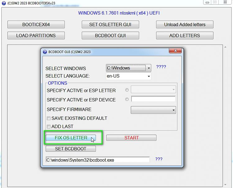

    You will need to adjust the os to new hardware AND fix the osletter. Cant remember if paragon fixes the osletter as part of the adjust process, I think it has a separate module for that.
    I have made a thing to do the osletter fix
