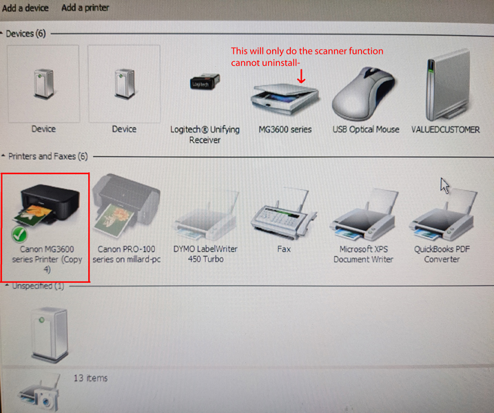

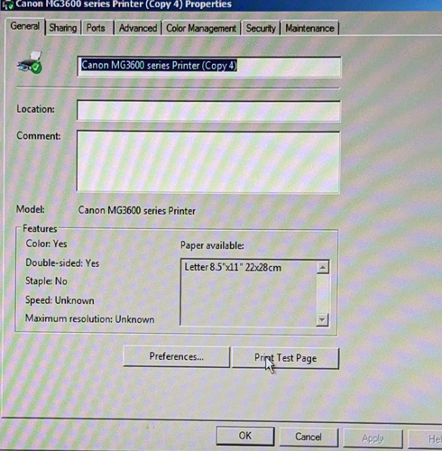

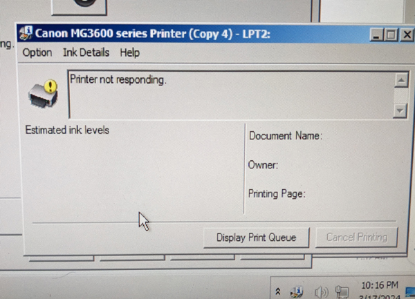

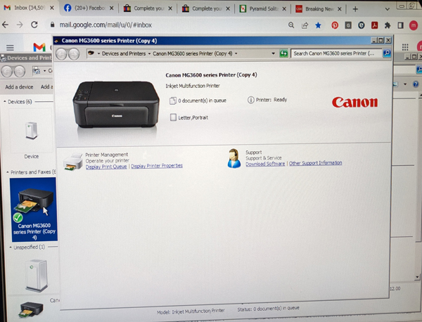

    replaced old 3620 after it said replace ink pad., but was printing fine, purchase a new identical 3620 printer loaded DVD fine, but would not initialize. Brought new printer over to another win 7 computer, DVD loaded and printer printed. Tried uninstalling drivers, tried different ports,replacing usb cable, loaded driver from Canon instead of the one that came with the cd.. Called Canon Tech support, and after 1 hour, tech said "call Microsoft".

    M$ seems to have problems with printers & scanners. I don't know id it is a 'USB' thing (which is probably part of the problem), but even after supposedly removing the drivers, the O/S 'remembers' the existence of that model and re-installs the driver package with a "Copy x"
    The fact that FOUR 'copies' are listed, I would say that may be the problem or at least part of it. I've run into similar problems with other USB devices.
