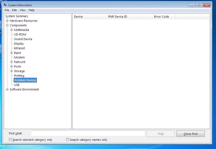

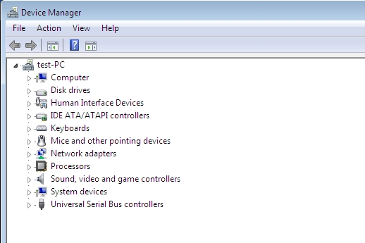

    - - - Updated - - -
    cant get any igpu drivers to work so far on gigabyte 310m s2h. It doesnt show Display Adapters in devmgmt, completely absent.
    yet nothing showing under problem devices
    vga drivers are working
    SDI offered the 5077 drivers and installed them. On restart just a black screen with no way out except hard shutdown.
    I have never come across that before.
