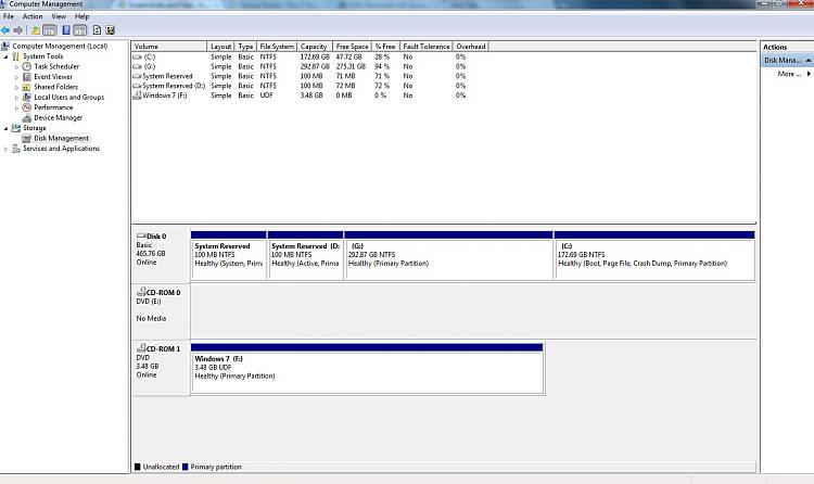

  3. Posts : 3
    Thread Starter
       #3
    Thanks for the quick response.
    I have Windows 7 x64 on both
    Attached Thumbnails Attached Thumbnails Configuring Dual boot on Windows 7 using BCDedit-untitled.jpg
  4. Posts : 22,814
    W 7 64-bit Ultimate
       #4
    OK, here's what I would do; mark the first "System Reserved" the one with no drive letter as "Active" then run the 3 separate startup repairs outlined in this tutorial at the link below to create a new set of boot files to that partition and that should automatically configure the Windows managed dual boot option; be sure to post back with any further questions you may have and to keep us informed.

    That worked great! thanks alot for taking the time to help me out. Really appreciate it!
